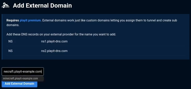

1. Add your domain to playit
Visit your account settings and add your domain.
Click on Add External Domain, and fill out your domain’s information. playit add external domain
Once you’ve done that, confirm your settings by clicking Add External Domain.

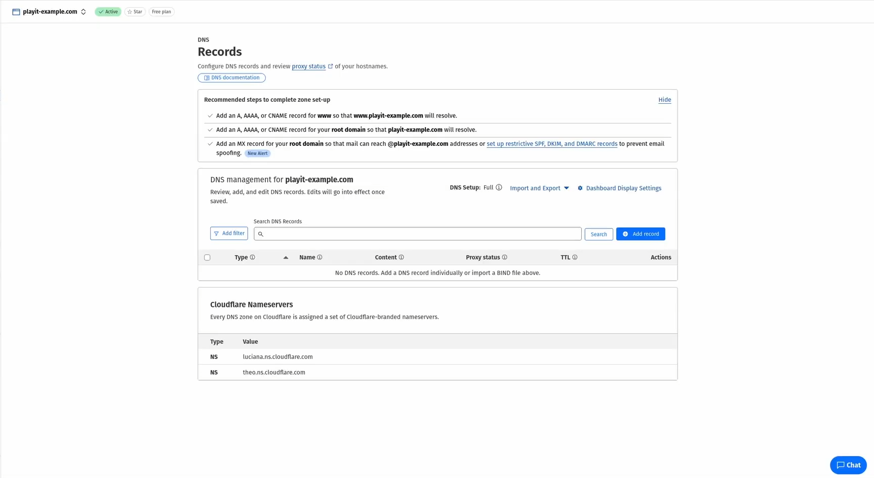

2. Visit your domain’s management page
Log in to the Cloudflare Dashboard, select your domain, and open the DNS → Records page.
cloudflare manage dns

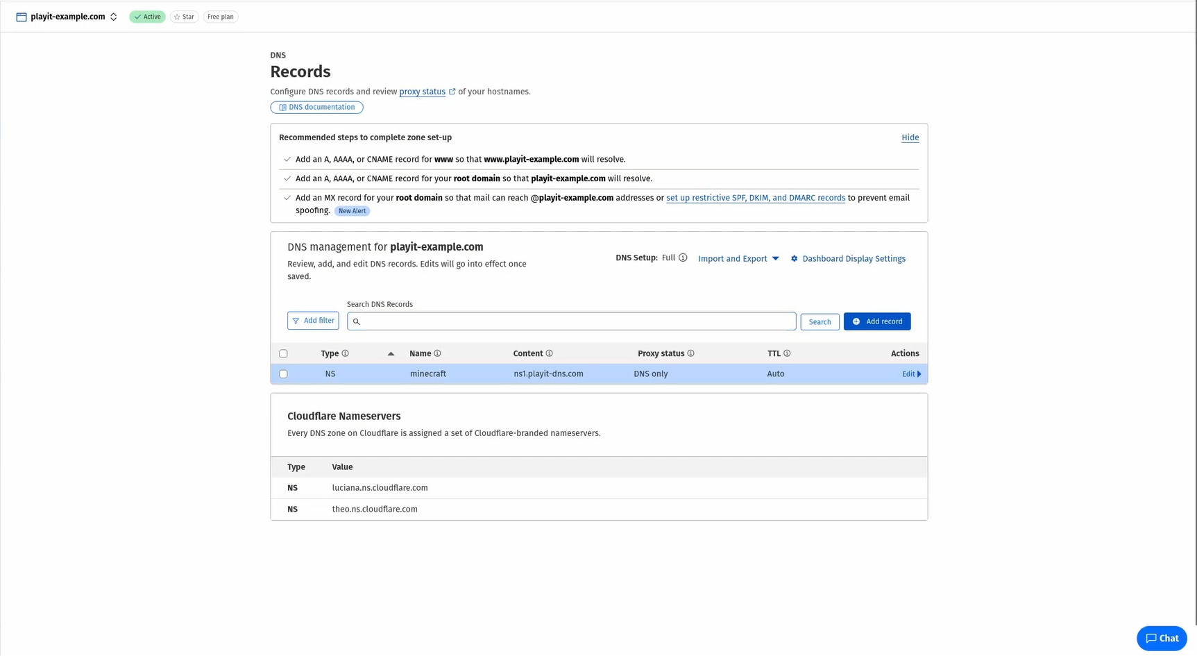

3. Add NS records for the sub domain
We will delegate the sub domain to playit.gg using NS records.
Create one NS record:
NS Record
  • Type: NS
  • Name: minecraft (might be different for you)
  • Target: ns1.playit-dns.com
  • TTL: Auto

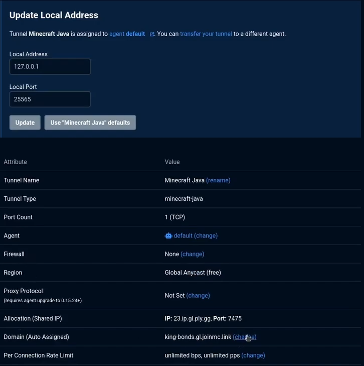

4. Assign your domain to a tunnel

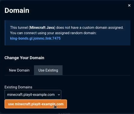

Edit or create a new tunnel, and scroll down until you see your tunnel attributes. You should see Domain (Auto Assigned). Click on change, go to Use Existing, and choose your domain from the dropdown menu
playit assign domain playit assign domain
Once you’ve selected your domain, click on use yourdomain.tld. Again, your domain will be different.

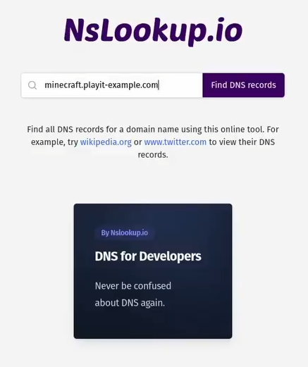

5. Check if the new domain is properly set up
To do this, we can use something like nslookup.io Enter your domain, and then click Find DNS records
check dns records check dns records
After adding your sub domain, it can take up to 1 hour before the update is seen globally. Usually it’s much quicker.
