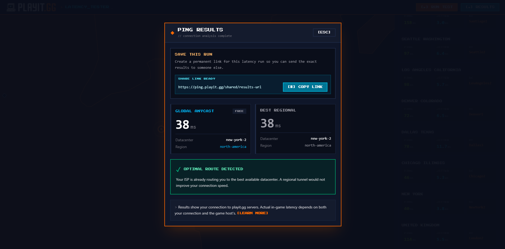

TL;DR
  1. Have your player(s) with high latency visit http://ping.gl.ply.gg and see which datacenter they are getting routed to (tunnel_name shows datacenter). If the datacenter is far from you and the player, consider getting using a regional tunnel with Playit Premium .

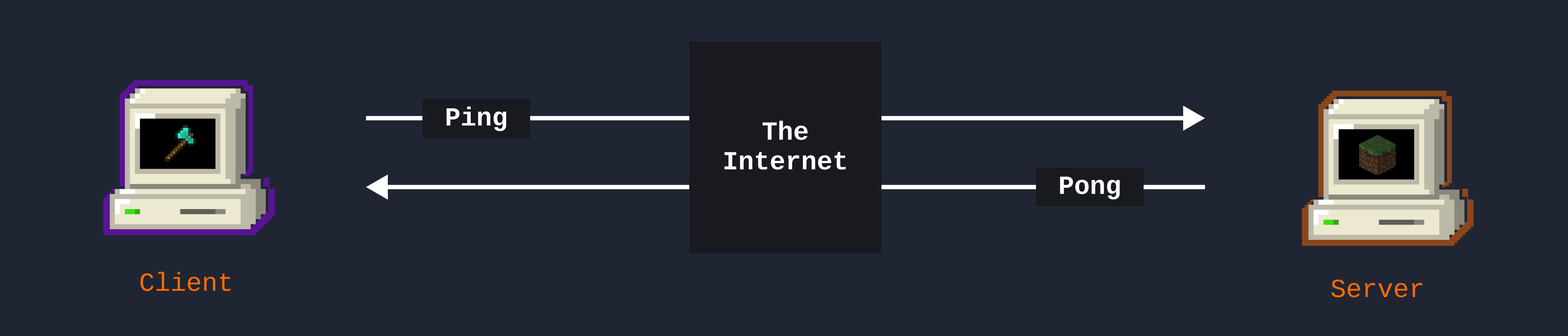

What is ping?
Simply said, ping is the amount of time it takes for you to receive a response from a target. If you want to measure your ping to one of playit’s servers, you can open the command line / prompt and run:
ping ping.ply.gg
The ping command will send an ICMP packet (a ping message) to one of playit’s global servers and that server will respond with a pong message. The ping command will then tell you how long it took in milliseconds to receive the response.

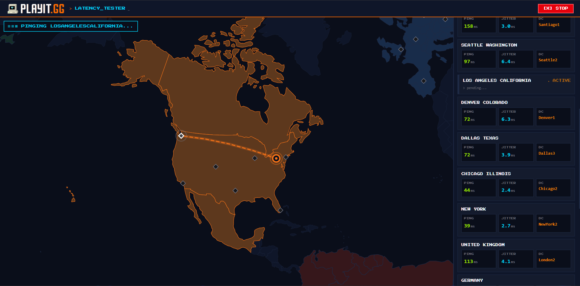

Adjust where client traffic goes
This requires playit premium. With playit premium you can create regional tunnels. A regional tunnel will ensure the player connecting to your tunnel will get routed to a datacenter in the tunnel’s region. Each player can approximate Latency(Hop 1) by finding their ping to the tunnel’s region and dividing the value by 2, Latency(Hop 1) = $(ping ping.<region>.ply.gg) * 0.5. If you’re hosing the server and also connecting, Latency(Hop 1) + Latency(Hop 2) = $(ping ping.<region>.ply.gg).
Ping commands to playit regions
ping ping.gl.ply.gg # Free Tunnel
ping ping.na.ply.gg # North America Tunnel
ping ping.eu.ply.gg # Europe Tunnel
ping ping.sa.ply.gg # South America Tunnel
ping ping.in.ply.gg # India Tunnel
ping ping.as.ply.gg # Asia Tunnel

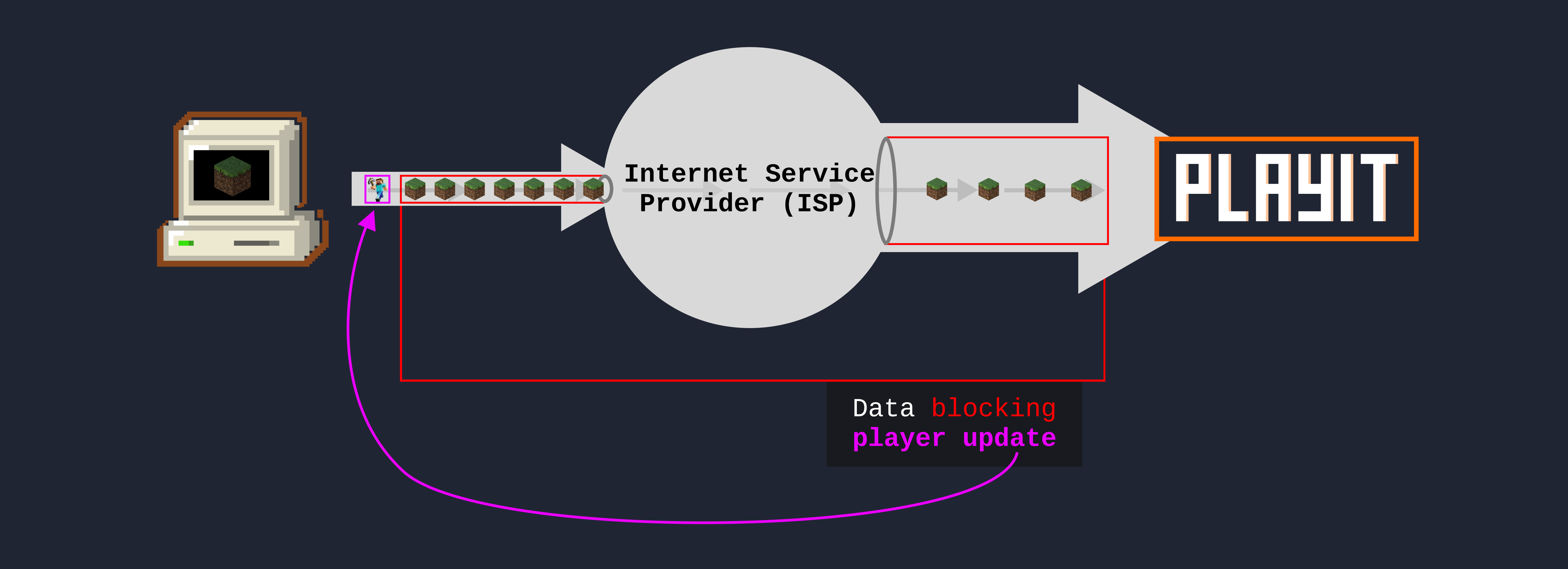

Every internet connection has an upload speed limit. Depending on your upload speed and game server (and game server settings) it’s very possible you’re hitting a limit which is causing delays and extra ping.
Saturating your upload bandwidth (upload speed limit) When you’re sending data to players you need to wait for that data to be sent before you can send more data. It’s a queue, if you’re trying to send too much data you’ll need to wait, this waiting can cause massive in-game ping / latency spikes.
agent-ping
Like everything, this is complicated. Some game servers are greedy and will use all available bandwidth to send data to a new player at the expense of other players.
Some examples with Minecraft Java With a Vanilla Minecraft Java server here’s how much data is sent to a connecting player based on view-distance:
  • view-distance: 4 => ~0.68MB
  • view-distance: 10 => ~2.34MB
  • view-distance: 32 => ~3.26MB
Worst case scenario with a 10Mbps upload speed (very common), a new player joining can temporarily spike the ping for all players on your server by the following milliseconds (ms). This can be even worse with multiple players joining at the same time.
  • view-distance: 4 => ~500ms
  • view-distance: 10 => ~1900ms
  • view-distance: 32 => ~2600ms
Most home internet routers have some form of Quaility of Service (QoS) prioritization applied to the upload bandwidth to lower how much one greedy connection can block others. Your router being ‘smart’ does help lower the affect but not eliminate it. It’s also possible your router is doing a bad job and might need a restart. See our section on Buffer Bloat for more details.
Through testing we’ve found the official Vanilla Minecraft Java server is greedy with bandwidth. PaperMC which we’ve also tested does a much better job smoothing out the traffic which can help lower this affect too.
